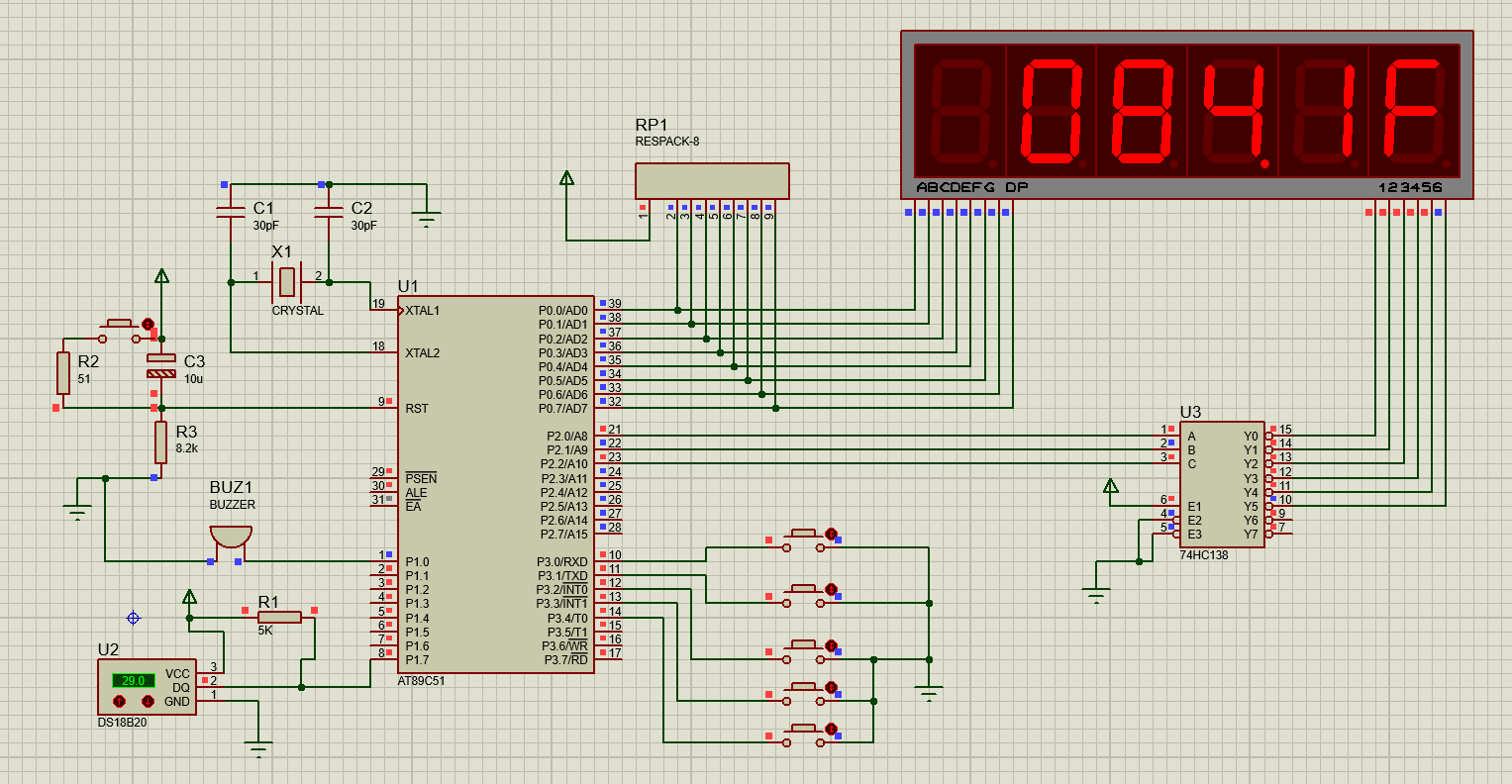

总原理图:
  20211411573626.png [ 101.22 KB 1522×793 ] (缩略时请点击查看原图)

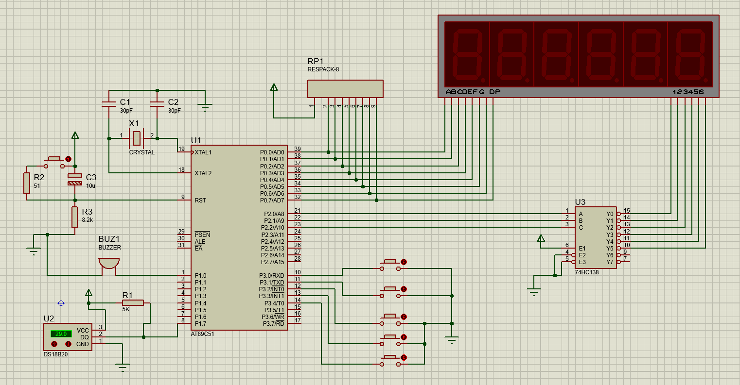

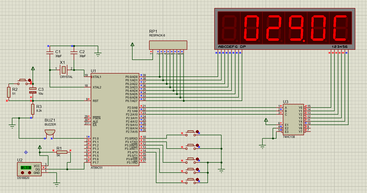

仿真图:
  2021141223826.png [ 105.59 KB 1527×792 ] (缩略时请点击查看原图)
  2021141232726.png [ 105.26 KB 1509×795 ] (缩略时请点击查看原图)
